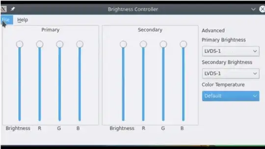

Install Brightness Controller from the following PPA.
sudo add-apt-repository ppa:apandada1/brightness-controller
sudo apt update
sudo apt install brightness-controller
Screenshot 1
Now you can adjust the brightness using the slider.

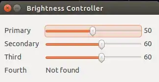

Here is the latest information for the brightness controller. There are 2 versions available. Version 1 aka simple version allows support for up to 4 monitors and maintains the classic sliders. Version 2 allows for more specialized control as well as multiple monitors.
You can check them both out here Brightness Controller
For faster install use the PPA
sudo apt-get update
Then for Version 1
sudo apt-get install brightness-controller-simple
Brightness Controller Simple
Or for Version 2
Enjoy!
