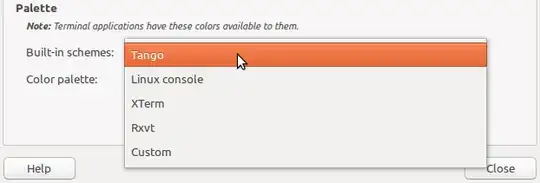

GNOME Terminal has a few built-in color schemes:
Built-in color schemes in GNOME Terminal
How can I add more to this list?

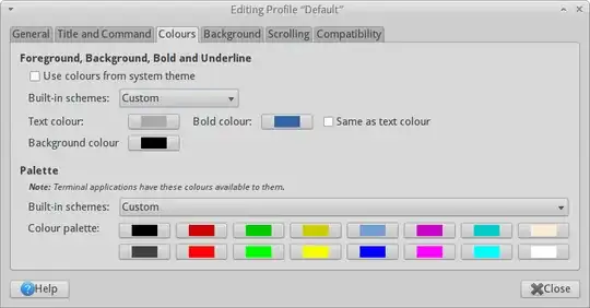

If you created a color scheme by experimenting with the menus (as in the screenshot below),
you could back it up by noting the instructions in this answer:

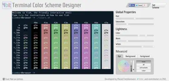

This awesome project might help to build these scripts:
4bit Terminal Color Scheme Designer 4bit Terminal Color Scheme Designer
