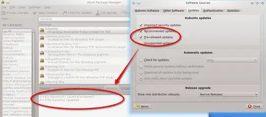

By the Kubuntu developers: http://irclogs.ubuntu.com/2012/11/17/%23kubuntu-devel.html
as per bug 1067611 we are trying to push 4.4.1 into regular 12.10, however first we need to assure that this release is of sufficient quality...
so i tis in a separate part of the official archive called 'proposed'... once it has been verified that the new version works as expected we can move it to from proposed to the regular archive
bug 1067611: https://bugs.launchpad.net/ubuntu/+source/kdevelop/+bug/1067611
Ubuntu proposed: https://wiki.ubuntu.com/Testing/EnableProposed
