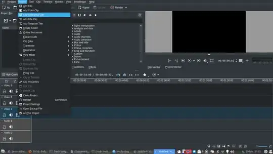

kdenlive works for me. You can install it from repo (sudo apt-get install kdenlive), but you can compile more codecs in with ffmpeg from source and kdenlive from source.
It looks a bit intimidating, but you don't need to know much to make a slideshow with it. First, put all the photos you want in a folder, then do Project → Add Slideshow Clip
adding slideshows
and select that folder (there are some options for transitions and such there too).
Then, drag that clip down onto the timeline, e.g. to "Video 1", and click Render, pick a file name and format and Render to file.
If you also want music, do Project→Add Clip and pick a song and then drag it down to the timeline. Right click the audio clip at the end of the slideshow clip and Cut clip so you don't get audio after the slideshow is done. Then Render.
