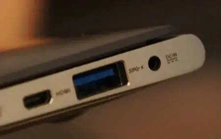

That said, I concur that the best way to determine if your hardware is USB3 is by looking at the ports themselves; USB3 is usually color-coded and is blue, and has some extra conductors (which are however a bit difficult to see). If a USB 3.0 port is not blue, you will most likely see the phrase "SS" for super speed next to it, like this:
Identifying USB 3.0 Ports

USB 3 ports are blue. Just look at the ports on your laptop. If they aren't blue, they aren't USB 3 ports. There is probably some terminal command to determine this but just visually inspecting the ports will be the simplest.
Edit: An anonymous user suggested a helpful edit which was rejected, but I think it's helpful as it proves my answer isn't 100% correct. I'll copy it verbatim below and hope it proves useful:
I have read many places that the UBS 3.0 ports are blue, but that is not true in my experiences. I have a Dell Latitude E6430 that does have two 2.0 USB ports and two 3.0 USB ports. They are labeled with the above mentioned SS marking, but there is no blue parts of any kind visible from the outside of the laptop.
I have been researching this subject for a bit and I'm seeing the, sometimes condescending, but not in this case, comments about just looking. They are not always blue and as a matter of fact I'm a software test engineer and I work with numerous computers through the day and I have yet to find one where the port had any blue showing externally. I have seen a device with some blue but not the computer port.
Thanks for listening!

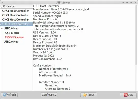

You should be able to find out by using a program such as UsbView, which gives very detailed and technical information. As noted on the github site,
USBView is a small GTK application to show what the device tree of the USB bus looks like. It shows...the topology of the USB bus. It also displays information on each individual device on the bus.
It has recently been updated, and is simple to compile and run. Here's how to do it:
First install some essential programs and gtk dependencies with
sudo apt-get install git build-essential libgtk2.0-dev libgtk-3-dev
Then enter
git clone git://github.com/gregkh/usbview.git
and cd to the usbview folder and run
./autogen.sh && ./configure
and then
make
You can either run sudo make install or sudo checkinstall, depending which you use.
When you run the program, you will need to use gksudo because of the probing it does:
gksudo usbview
You will see a screenshot as below detailing your usb capabilities: the host controllers listed will show the capabilities you have: I have no usb 3 host controller present.
