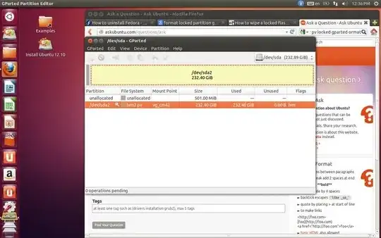

I can't format my hard disk for Ubuntu installation. It has Fedora installed in it. I wonder how to unlock the locked partition to delete and format it, since I am stuck at installing Ubuntu. I am now using a live CD to do the task. No options are available for me to use.
Screenshot:
Screenshot of GParted

If it's an LVM partition, you will need to deactivate it using the command lvremove which will remove the lock.
Only then can you delete the partition using gparted.
Use lvscan to view the volume.
Use lvremove to remove it.
Check man pages man lvscan and man lvremove for details.

My 'active distro' occupied another drive, I just wanted to get rid of the Fedora LVM - fedora doesn't play nice with other distro's destroyed my 'grub2' list and wouldn't allow any other distro to boot, so needed to 'get rid'
lvscan + lvremove as sudo worked a treat
$ sudo lvscan
  ACTIVE            '/dev/fedora_localhost/swap' [7.81 GiB] inherit
  ACTIVE            '/dev/fedora_localhost/home' [407.39 GiB] inherit
  ACTIVE            '/dev/fedora_localhost/root' [50.00 GiB] inherit
$ sudo lvremove /dev/fedora_localhost/swap
Do you really want to remove and DISCARD active logical volume swap? [y/n]: y
Logical volume "swap" successfully removed
$ sudo lvremove /dev/fedora_localhost/home
Do you really want to remove and DISCARD active logical volume home? [y/n]: y
Logical volume "home" successfully removed
$ sudo lvremove /dev/fedora_localhost/root
Do you really want to remove and DISCARD active logical volume root? [y/n]: y
Logical volume "root" successfully removed
Issue resolved ... thanks 'geezanansa'
