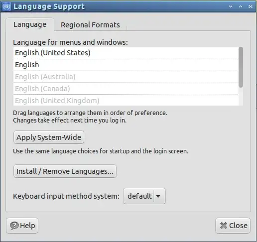

In Lubuntu's Language Support application I see no way of differentiating between different types of the same language (English US, UK, etc) nor between different types of keyboard layouts for the same language (standard, etc). To select a certain special keyboard layout I had to edit manually /etc/default/keyboard.

  • In order to install different languages that are to be used by the system, Lubuntu has the Ubuntu Default Language Manager.
This should be easily accessed through the Preferences>Language Support. Check here to see if the application is installed.
/usr/bin/gnome-language-selector
Chosen Language

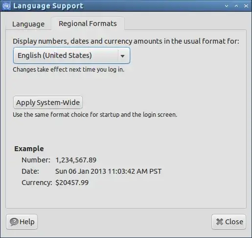

Regional Support
If you do not see nor can confirm the application is installed then open a terminal and install it by using the following command sudo apt-get install language-selector-gnome
Once installed you will have access to all the major Language/Regional formats

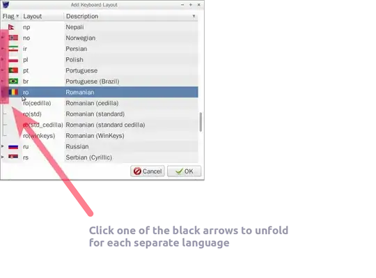

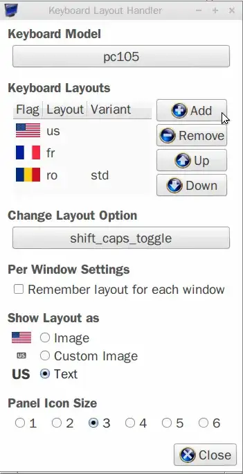

  • In order to chose between different types of keyboard for the same language -
    Be sure Keyboard Layout Handler is visible in the LXPanel. If not, right click on the lxpanel, "Add/remove panel items" and add it. Then edit it. If it is already visible, right click on it and select "Keyboard Layout Handler" Settings.
Then click "Add"
