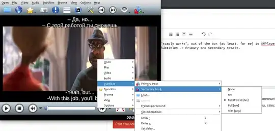

The easiest option that "simply works", out of the box (at least, for me) is SMPlayer. In context menu, select Subtitles -> Primary and Secondary tracks: screenshot

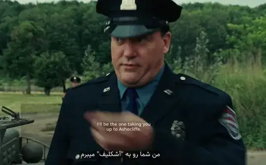

The best and simplest way i found is to play second subtitle with a standalone subtitle player like PenguinsSubtitlePlayer.
Here is a demo: enter image description here Hope it helps.

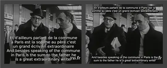

Aegisub merges and positions subtitles where you want in a single file:
sudo add-apt-repository ppa:alex-p/aegisub
sudo apt-get install aegisub
.srt's (left) will pile subs on top of each other and font settings aren't conserved so be sure to save the result as an .ass/.ssa file (right).
srt-versus-ass-subtitle rendering
