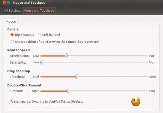

I simply do not have the option for "two-finger scrolling" available in my "Mouse and Touchpad" settings. I have tried a lot of terminal commands that I have found in the forums with no success. Who has a solution that will enable two-finger scrolling?
A little about me:
Ubuntu 12.04.1 LTS \n \l
Built-in Pointing Device
    Type: Mouse
    Interface: PS/2
    Buttons: 2
~$ xinput list
⎡ Virtual core pointer                      id=2    [master pointer  (3)]
⎜   ↳ Virtual core XTEST pointer                id=4    [slave  pointer  (2)]
⎜   ↳ PS/2 Synaptics TouchPad                   id=15   [slave  pointer  (2)]
⎣ Virtual core keyboard                     id=3    [master keyboard (2)]
    ↳ Virtual core XTEST keyboard               id=5    [slave  keyboard (3)]
    ↳ Power Button                              id=6    [slave  keyboard (3)]
    ↳ Video Bus                                 id=7    [slave  keyboard (3)]
    ↳ Power Button                              id=8    [slave  keyboard (3)]
    ↳ Sleep Button                              id=9    [slave  keyboard (3)]
    ↳ WebCam SC-13HDL10931N                     id=10   [slave  keyboard (3)]
    ↳ AT Translated Set 2 keyboard              id=14   [slave  keyboard (3)]
Screenshot of system settings:
