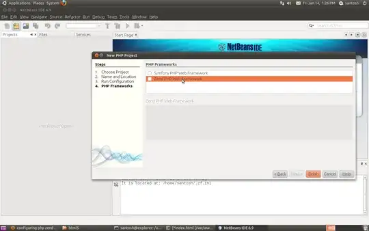

Anyone installed zend-framework plugin? I installed it, but cannot create any php-zend-framework projects. Here is a screenshot:
alt text
In this project I am not able to check the checkbox (neither zend nor symfony). Any ideas?

First, be sure you have the Plugin installed, ubuntu Netbeans installation is a vanilla one pretty much, you gotta add your plugins manually. once you do so, go to Tools -> Options -> PHP -> Zend and configure it. Then, start a new project :)
The plugin is called "PHP Zend Framework"
