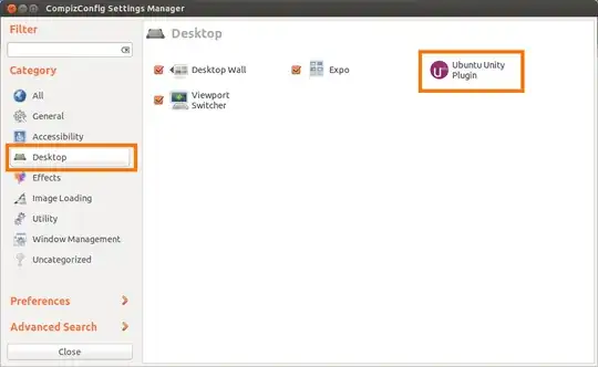

You need to launch CCSM and make sure that Enable Ubuntu Unity Plugin is ticked.
If you don't have CCSM installed, do the following:
  1. Press Ctrl+Alt+T to launch the Terminal.
  2. Type the following command and press Enter
    sudo apt-get install compizconfig-settings-manager
  3. Now, launch CCSM by running this command from the Terminal:
    sudo ccsm
  4. In the CCSM window, select Desktop → Ubuntu Unity Plugin.
  5. In the next window, make sure Enable Ubuntu Unitu Plugin is checked.
