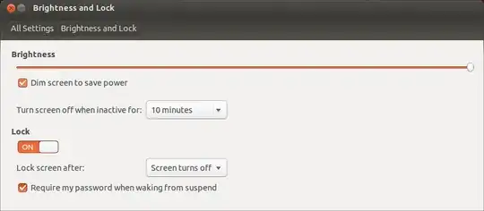

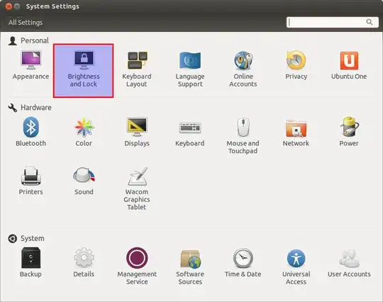

If that does not get the Fn+F6 and Fn+F7 keys working, you can do this via the system settings as seen below:
System settings
Brightness and lock
