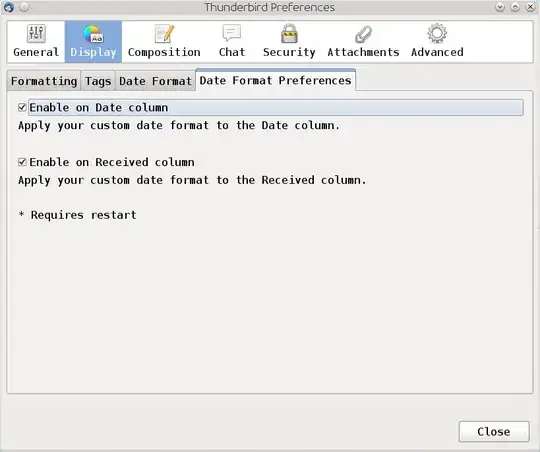

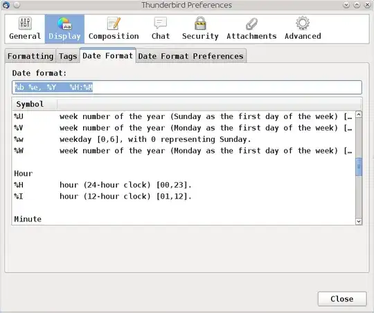

There's a Super Date Format thunderbird addon:
Philip
  • 103

There is a simple solution for the time and date format issues - a newer plugin works for Thunderbird 60+ that allows full customization of the time and date formats. It's called "Enhanced Date Formatter" and is in the list of extensions inside Thunderbird. Just fire up Thunderbird and search for it, install it, and customize however you want.
Compatico
  • 154
