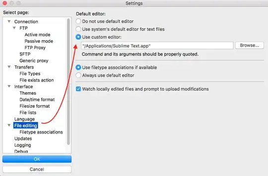

Go to Edit -> Settings and navigate to File Editing.
Choose Use custom editor and browse the executable file of Sublime Text 2.
Close the dialog by pressing OK.
Done!

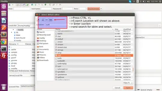

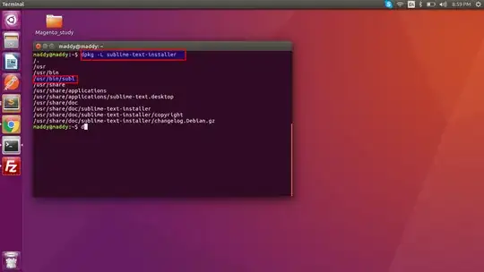

All the above posts are correct, i am just sharing with pictures for better understanding and I am using ubuntu 16.04 with updated FileZilla.
Run this command. dpkg -L sublime-text step1
step2
Press CTRL + L and Search for /usr/bin sblm and select. step3

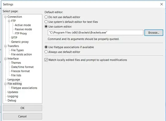

Here are steps to do it quickly -

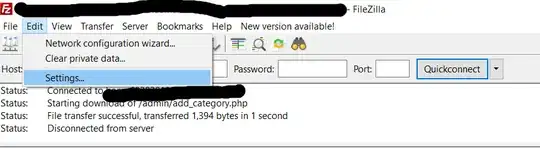

Step 1: Open Filezilla > Then Click on Edit Menu. Under Edit Submenu Click on Settings ( As Shown in Screenshot Below)

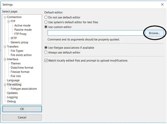

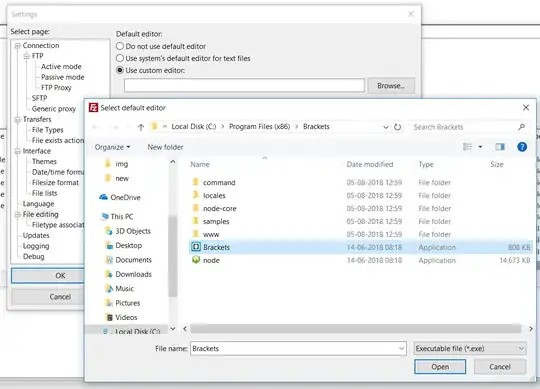

Step 2: In Settings Window Click on "Use Custom Editor" Radio Button -> Then Click on Browse Button To Choose your Default Text Editor / Code Editor. ( As Shown in Screenshot Below )
Step 3: In Browse Window Navigate to Installation Directory of your TextEditor You wish to use. In my use I am using "Brackets" Text Editor So I navigated to "C:\Program Files (x86)\Brackets\Brackets.exe" that is installation directory of my text editor.
Step 4: Then Click on Ok Button to close Settings Wizard.

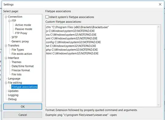

Step 5 - In Settings Window that you opened in step 1 -> Click on FileTypeAssociations -> It will show list of all files extensions configured to open in specific text editor. See screenshot below -
You can see in above screenshot some of my filetypes are associated still with notedpad.exe. for example - i was trying to open .php file from ftp in my default text editor but its associated with notepad.exe that's why it was not opening.
In order to open php file in my default editor from FTP I changed below line
php C:\Windows\system32\NOTEPAD.EXE
to this line below -
php "C:\Program Files (x86)\Brackets\Brackets.exe"
I have done it for php you can do it for any other filetype you wish and also for any other texteditor you wish.
