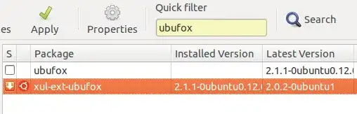

    • search for application you want and select it :
      you can use QuickFilter to find your application, and then select it from result

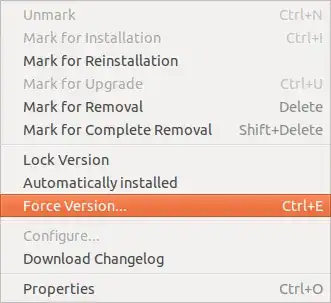

    • from menu select Package and select Force Version :
      you can use Ctrl+E to use Force Version

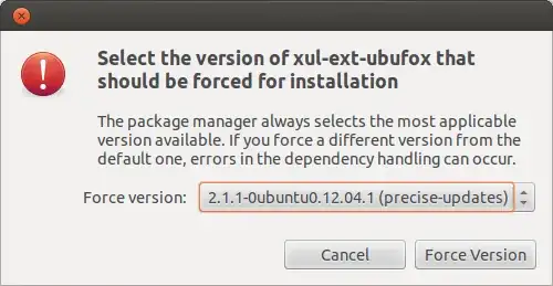

    • new window opened and you can select which version you want, and click on Force Version button :
      select version from drop-box
    • now this window closed and you return to Synaptic window, and you see the red icon inside the application checkbox, and Apply button now enabled, click on Apply to apply your changes :
      click Apply
