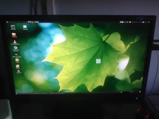

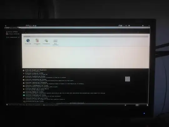

i have last ubuntu installed (10.10), but from an year and thousand updates, video drivers updates, an hundreds of tricks, the mouse pointer is showed like an UGLY square...
These are the screenshots:
alt text
alt text
I have no idea what to do to solve this problem. Anyone of you have an idea to solve it?
Edit: this problem was encountered from 8.10+!

You have a VIA graphics card, it's one of the worst supported graphics chipsets.
What is happening is that the hardware cursor (that's a special part of the graphic card capability that produces a nice smooth cursor) has been corrupted. Normally this is because all of your video memory has been used.
If you can go into the bios and increase the amount of RAM given to the onboard video device. This may solve the issue for you.
It may still be a driver issue, as I said at the start, VIA isn't well supported so you may want to upgrade to an nvidia, intel or ati graphics card.
If your /etc/X11/xorg.conf file exists and has a Device section, you can set it to use a software cursor. Just add the line
Option        "SWCursor" "true"
in that section. This should make the cursor be rendered in software, not by the graphics card.
