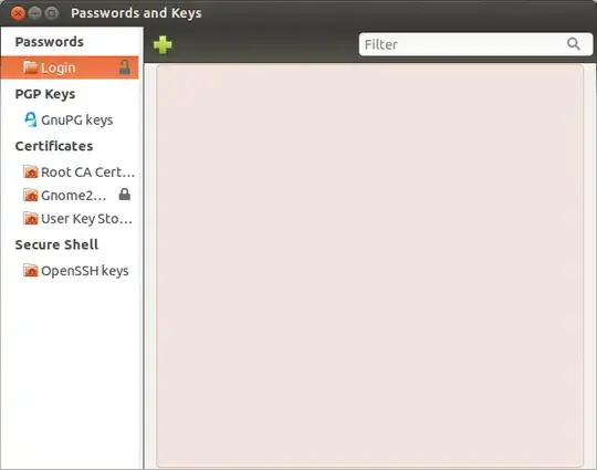

I changed the disk on my laptop and installed Ubuntu on the new disk. Old disk had 12.04 upgraded to 12.10 on it. Now I want to copy my old keyring with WiFi passwords, ftp passwords for nautilus and ssh key passphrases.
I have the whole data from the old disk available (is now a USB disk and I did not delete the old data yet or do anything with it - I could still put it in the laptop and boot from it like nothing happened). On the new disc that is now in my laptop, I have installed 12.10 with the same password, user-id and username as on the old disk. Then I copied a few important config files from the old disk (e.g. ~/.firefox/, ~/.mozilla, ~/.skype and so on, which all worked fine... except for the key ring:
The old methods of just copying ~/.gconf/... and ~/.gnome2/keyrings won't work. Did I miss something?
New empty keyring even after copying .gnome2

Migrate keys and passwords
Finally I know, what was wrong. First of all the keys moved from the old ~/.gnome2/keyrings to the new ~/.local/share/keyrings. Probably due to the switch from Gnome to Unity. Also there seem to be additional files there, aside from the usual login.keyring and user.keystore. At least there where for me after a fresh install. Those hinder migration and I had to delete them.
As mentioned both user ID and user password on my new system matched their counterparts on the old system. If for you they don't, it might probably work to set the password on your old installation to blank (i.e. change your password to no password / empty password). Do that prior to backing up your old system.
Now here is what I did:
  1. Backup the keyfile of the fresh installation in case something goes wrong:
    mv ~/.local/share/keyrings ~/.local/share/oldkeyrings
    Using move also makes sure that the other new files in ~/.local/share/keyrings are not there to interfere.
  2. Copy the old keyring to the fresh installation:
    mkdir ~/.local/share/keyrings && cp -r /BACKUPDESTINATION/home/$USER/.gnome2/keyrings/{login.keyring,user.keystore} ~/.local/share/keyrings
    For gpg keys you'll have to copy ~/.gnupg over to the new install as well.
  3. Make sure only you can access them and own them:
    sudo chmod -R 600 ~/.local/share/keyrings/ && sudo chown -R $USER:$USER ~/.local/share/keyrings
    (might not be necessary)
  4. Log out and back in again
