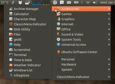

Another alternative is to use unity or gnome and get the functionality you like about Gnome Classic. There is a Classic Menu Indicator, for instance.
Here is a quote from http://maketecheasier.com/10-must-have-indicator-applets-for-ubuntu-12-04/2012/06/15:
ClassicMenu Indicator:
Aw! You miss the good old classic Gnome2 menu which stayed with Ubuntu till version 10.10 but bid farewell since Ubuntu switched to Unity/Gnome 3. Here is a good news fellas! We have this tiny little applet that gives you (to an extent) same classic menu feel.
The .deb file is available to be downloaded from here. - See more at: http://linux.softpedia.com/get/Desktop-Environment/Tools/ClassicMenu-Indicator-70007.shtml
That indicator is written by Florian Diesch (also a Ask Ubuntu user).
