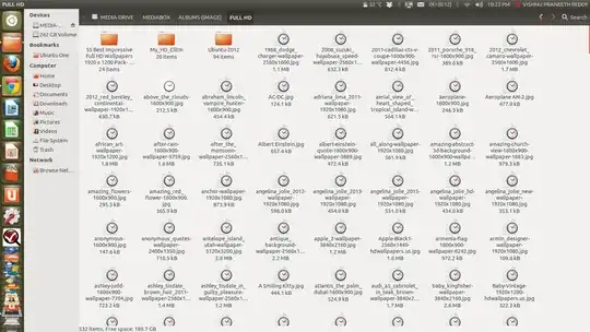

This started to happen after upgraded Ubuntu from 12.04 to 12.10.

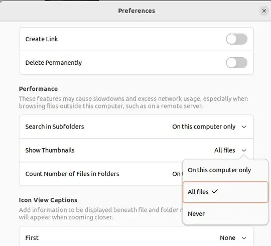

As previously pointed out, there is a setting in Nautilus preferences to show thumbnails on your local computer or always. The wording is however different now.
  1. Nautilus
  2. Preferences / hamburger menu, top right, preferences
  3. Scroll down to the "Performance" heading
  4. Change "Show Thumbnails" to "All files" (from "On this computer only")
As always, be ready for slight changes in naming in upcoming releases.
