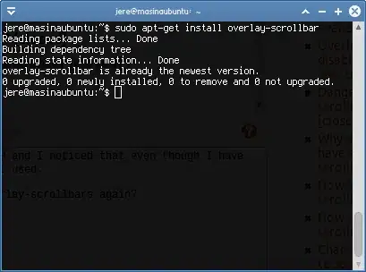

I just did a release upgrade from Ubuntu 12.04 to 12.10 and I noticed that even though I have the overlay-scrollbar package installed, it is not used. I have tried purging and reinstalling the package, but nothing has changed even after reboot (see screenshot).
What can I try to do to get the overlay-scrollbars working again?
overlay-scrollbar is installed
