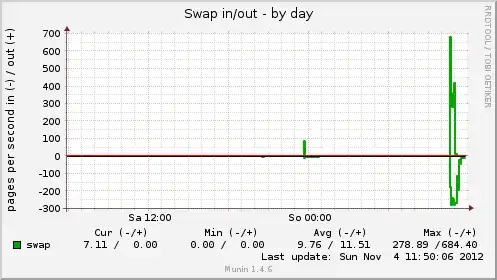

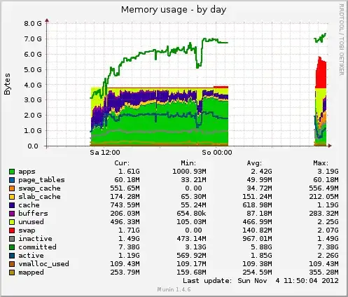

I regularly put my machine into suspend-to-ram (S3) and when the machine comes back up Ubuntu starts to swap out processes. I was able to observe that the used swap-space starts to grow right after the box returns. See munin graphs below, the gap (obviously) shows the timeframe in STR.
Memory usage by day
Swap in/out by day
Needless to say that the box becomes unusable while swapping, load goes up beyond 10.

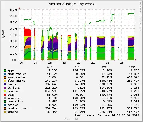

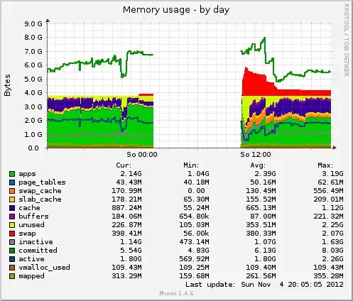

EDIT: Further progression of memory usage, same day, broadly using the same apps all the time:
EDIT2 (resolved): I disabled my discrete ATI card in the evening of Nov. 20th and rebooted. The swap usage then dropped (see the missing red area in the Munin graph) and did not reappear since then while the box did a couple of suspend/fully-on-cycles.
The root cause seems to be AMD's ATI fglrx driver (Catalyst) for radeon (Radeon Mobility HD 3650 in my case).
