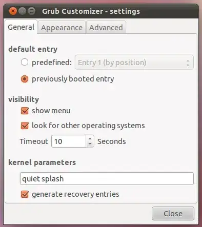

you can install GRUB customizer (http://www.liberiangeek.net/2012/09/grub-customizer-3-0-released-install-it-in-ubuntu-12-04/) to make your work easy. you will see following screen once you install GRUB customizer :
Let me know if this helps solve your problem
