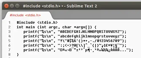

I think that the Fixedsys font is one of the most legible monospaced fonts for programming. It has zero antialiasing, with vertical lines mostly 2 pixels wide. Close to ideal for current monitor dot pitches, in my eyes (literally). Here is a sample:
Fixedsys sample
