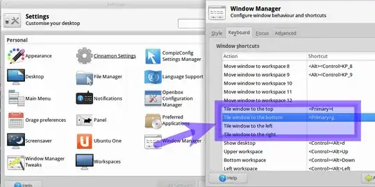

Using settings manager --> window manager you have the Tile Actions as shown.
In the picture I have defined two custom keyboard shortcuts CTRL+T to tile the current window to the top and CTRL+G to tile to the bottom.
To define your own keyboard shortcut - double click in the shortcut field next to the action.
