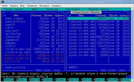

If it's hard to use pure shell commands, then you can install Midnight Commander, console application that makes it easier:
$ sudo apt-get install mc
Midnight Commander Screenshot
In Midnight Commander to move folder or file from one panel to another is F6, copy F5.
$ mc
If you need root access
$ sudo mc
If you want to have a mouse support
$ sudo apt-get install gpm
