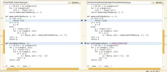

You can compare two text files very easy with diff and even better with meld:
example meld

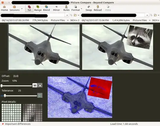

This question was ask back in 2012, and it's 2017. We now have the non-open-source program Beyond Compare to compare images, and it integrates into Nautilus. We have also had Geeqie all along for finding similar images throughout a directory structure (recursively).
I. Finding Image Differences With Beyond Compare
Click this link to download Beyond Compare .deb packages.
Install the package by going to the directory you downloaded the package too, and typing: sudo dpkg -i YourPackageName.deb which at this moment is called bcompare-4.2.2.22384_amd64.deb, so you would type: sudo dpkg -i bcompare-4.2.2.22384_amd64.deb
To complete the install and get the plugin to work in Nautilus, you will need to log out, and then back in, because Nautilus is running in the background even if you don't have it open.
Once it is installed and the plugin is working properly, you:
  1. Open Nautilus, and browse to the first image
  2. Right-click the first image to bring up the context menu, and select Select Left File for Compare/Merge
  3. Browse to the second image
  4. Right-click the second image, and select Compare to 'NameOfFirstImageFile' where NameOfFirstImageFile is the name of the file you selected in step 2.
  5. The images will then open up in Beyond Compare, and it will look something like this:
    Beyond Compare Image Comparison

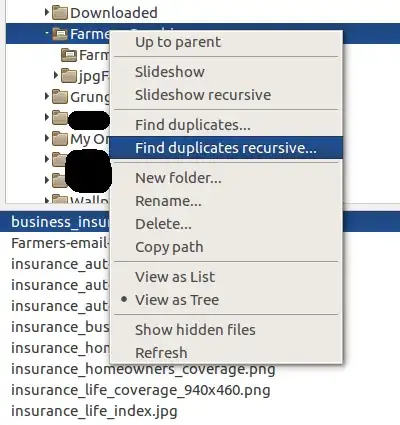

II. Finding Similar/Duplicate Images With Geeqie
  1. Install Geeqie by tying this into a terminal: sudo apt install geeqie
  2. Open Geeqie, and browse to the directory you want to scan.
  3. Right-click the name of the directory you want to scan and select Find duplicates... to just scan that directory, or select Find duplicates recursive... to scan that directory and all directories under it.
  4. Using the Compare by drop-down list in the lower left corner, you can choose to find duplicates by Checksum, by Filename, or by Similarity levels. The similarity feature is awesome if you have cropped, rotated, or resized images, you no longer need, as many of us acquire, when we crop/resize pictures to post on social media and such.
