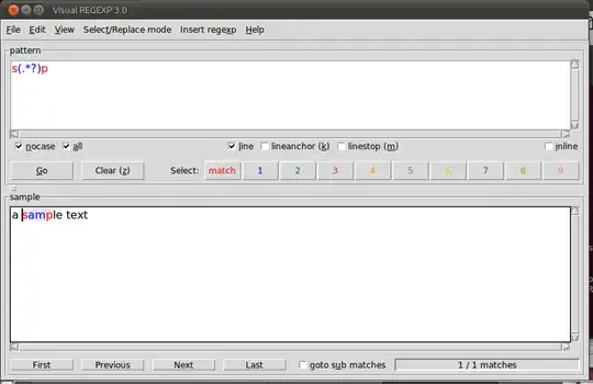

I just found Visual REGEXP : a graphical explorer for your regexps, which is a Tck/Tk application, so I wanted to try it on Ubuntu 11.04 natty.

Finally, note that visual_regexp-3.1.tcl apparently is still marked as 3.0:
