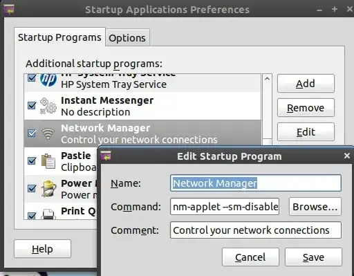

You'll need to start the network manager applet. It's started by default, although it sounds like you've done some customisation. Here's a screenshot of my entry :
alt text
This is available through system/preferences/startup applications.

Network Manager is a separate beast from its applet for good reason: Network Manager is a daemon that persists outside of X. The applet just communicates with this daemon.
Anyway, you want to run this:
nm-applet --sm-disable
It's set to run on boot on my computer from System -> Preferences -> Startup Applications.
