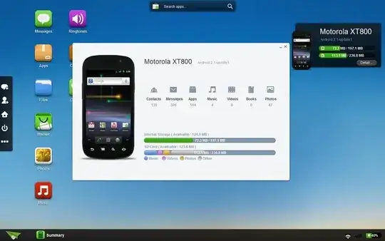

For my personal use, I've used instructions similar to those that @K.K Patel provided in their answer.
However, some users either do not want to, or are uncomfortable with using the command line. For them, I recommend using AirDroid.
This solution does not require any configuration on the Ubuntu systems.
All that is needed is an application installed on the Android phone, a shared wireless connection between the phone and Ubuntu system, and a web browser on the machine running Ubuntu.
On the Android phone, follow these steps:
  1. Go to this link: https://play.google.com/store/apps/details?id=com.sand.airdroid&hl=en
    or:
    • Start the Google Play application
    • Search for AirDroid
  2. Install the AirDroid application
  3. Start the AirDroid application on the phone The AirDroid application will provide a URL to connect to as well as a QR confirmation code. Make note of these two bits of information.
On the Ubuntu system, follow these steps:
  1. Start a web browser.
  2. Enter URL provided by AirDroid from the phone (i.e. 198.168.1.4:9100(substitute the actual IP address and port number here))
  3. The user will be prompted for a login. Use the QR code provided by the phone. You can also choose to connect via https for a more secure connection.
After logging in, a 'desktop' will be presented, through the web browser, to communicate with your Android phone:
This provides a simple method of transferring files, photos, updating contacts, etc. between the Android phone and Ubuntu system.
