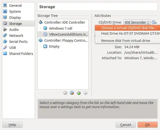

I don't get how to do: CD/DVD Drive.

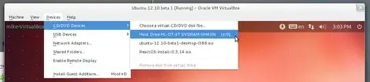

First make a new machine with your desired settings. Then boot the empty machine, open up Devices -> CD / DVD Devices and select your DVD drive with the disk in it. If you need more help let me know.

In Virtualbox, after you have setup the machine you have two options.
  1. Use your host DVD drive and put Windows 7 DVD in the drive
  2. Use an .iso image as your boot DVD
I usually use an .iso image, but if you have a DVD that is just as easy. Just use 'Host Drive..."
