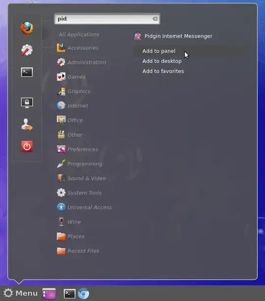

To add Pidgin in the panel par, go to Menu and search for "Pidgin". When it found, right click on it and select Add to panel:

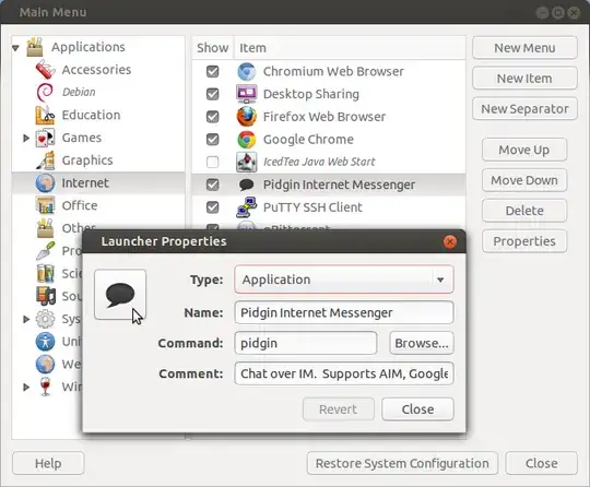

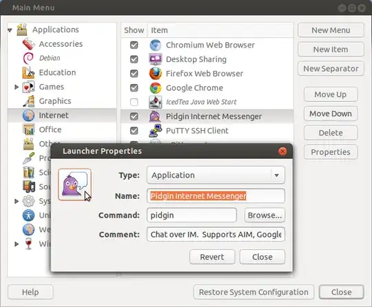

To change the icon for Pidgin, go to Menu search for "Main menu" and open it. When it open, search for "Pidgin" application, click Properties and change the icon by clicking on it:
change icon change icon
