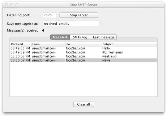

Another approach is to run a "FakeSMTP" server, a cross platform SMTP handler; who's whole purpose is to receive emails, store and display them with your configured email client.
FakeSMTP Screenshot
