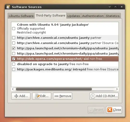

The same data can be seen in Software Sources dialog:
