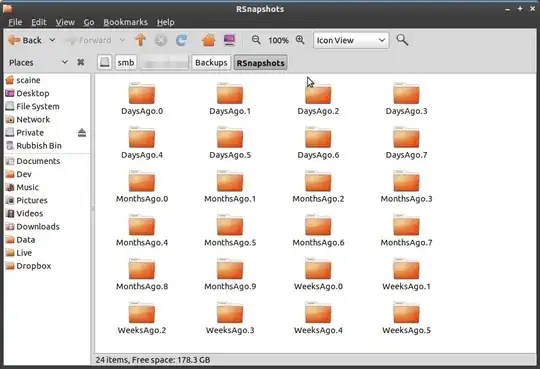

For my rsnapshot, I use "daysago", "weeksago" and "monthsago" :
alt text
