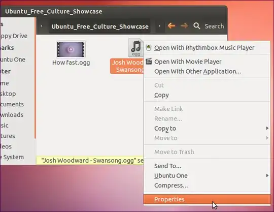

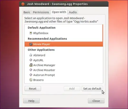

According to here, Right click the file of the format you want, select properties:
Go to the open with tab, select the program you want to be the default for that type of file, then press the button Set as Default:
