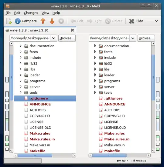

meld is a good graphical diff frontend that will show you a side-by side listing of files. Install meld with Ubuntu Software Center:
Install via the software center
Or use these commands with the terminal:
sudo apt-get install meld
meld dir1 dir2
meld in action
