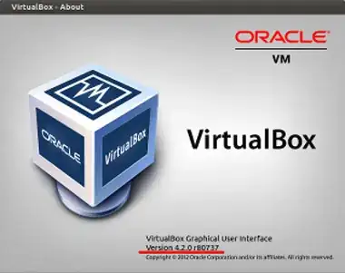

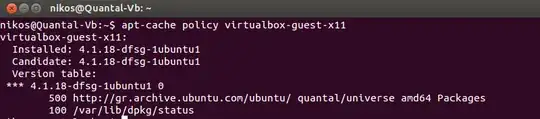

For VirtualBox version 4.2.0 . Oracle's Version.
Install the package virtualbox-guest-x11 and you will be fine.
From terminal (Virtual System)
sudo apt-get install virtualbox-guest-x11
Reboot you Virtual System.
