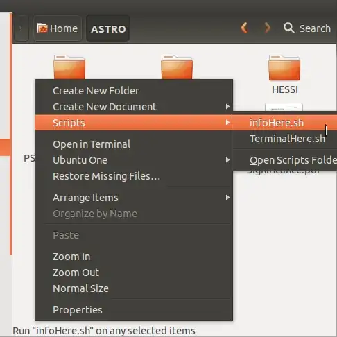

The resulting menu looks like this.
Running this script will output a file called info.txt with the content of the important environment variables that you can use in your script.
