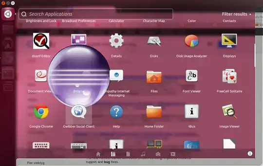

I have a problem with the manual installation of Eclipse Juno. After unpacking the tarball to /opt, adding a symlink from /usr/local/bin and adding the following to a new file /usr/share/applications/eclipse.desktop:
[Desktop Entry]
Version=1.0
Name=Eclipse
GenericName=Integrated Development Application
Comment=Eclipse Juno
Exec=/usr/local/bin/eclipse
TryExec=/usr/local/bin/eclipse
Icon=/opt/eclipse/icon.xpm
Terminal=false
Type=Application
Categories=Development;IDE;
I still get this weird behavior from the dash:
Huge icon in Unity dash
Eclipse runs just fine and the icon is clickable but as you can see the size is a bit off. How can i fix this? Shouldn't Unity automatically scale the icon?
