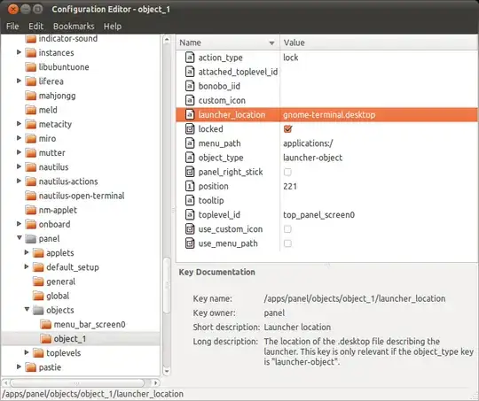

The launchers are registered in subfolders of /apps/panel/objects in the GConf settings database:
Configuration Editor showing gnome-terminal launcher registration
To backup all your panel launchers, you will need to copy both the launchers and their registrations:
  1. launchers: $HOME/.gnome2/panel2.d/default/launchers/
  2. registrations: $HOME/.gconf/apps/panel/objects/
