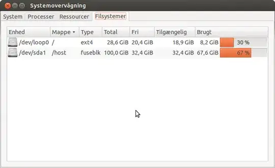

At the moment, I see two partitions when viewing the system monitor: one 28.6 GByte ext4 partition which must be the one containing Ubuntu and one 100 GByte fuseblk partition which I assume is the one holding Windows. It shows that I have 18.6 GByte free space on the ext4 partition. Can I "take a bite" from the ext4 partition and convert this into a swap partition? I was thinking something like 3 GBytes for swap considering my limited RAM.

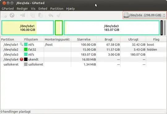

Regarding the actual question of swap: When I run gparted, it shows me that there is one ntfs partition of 100 GBytes from where it boots and the before mentioned ext4 partition of 28.6 GBytes is not mentioned. Could it be that my ubuntu installation resides inside this 100 GBytes ntfs partiotion? And if so, can I take a bite of this for my swap partition?
Realising that gparted is shown in Danish, I hope that you can make out what I mean.
System monitoring shows below details: enter image description here

Yes, you can change the size of your partition and create a new one using a program called gparted.
However, you should boot the computer from the LiveCD or USB installation (with the "try Ubuntu" option), because you cannot modify partitions which are in use.
After you have used gparted (which is pretty intuitive, but google if you have any problems) and your swap has been successfully created (remember to tell gparted to format the partition as Linux swap!), you will have to boot modify the /etc/fstab file to tell it to use the new swap partition.
