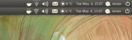

I've seen someone had a coffee cup on their taskbar, in their indicators, and was wondering how I can get it. I think it was something to do with Java.

the application you are looking for is called caffeine (http://ubuntu-tweak.com/app/caffeine/)
depending on your ubuntu version you can install it using these commands
sudo -s
add-apt-repository ppa:caffeine-developers/ppa
apt-get update
apt-get install caffeine
there is no port to Ubuntu 12.10 though, so if you are using Ubuntu 12.10, you have to wait until the developer packed it for Quantal
