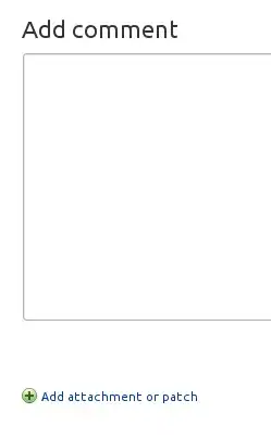

you can add more information from comment field . if you want to upload any files can choose attachments.
look at the image
