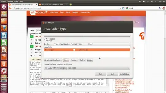

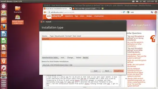

I am trying to install Ubuntu into this G drive. I want to keep my windows 7 files and installation intact. I have tried it a while ago for 11.10 and at that time it all went super smooth. I have tried rebuilding the partition table from cmd.exe in windows and i have also tried by formatting my G drive to ext3 using Easeus Partition manager in windows and then installing using wubi but wubi.exe didn't detected the partition formatted to ext3. When i ran the installation wizard from within ubuntu running through live usb, i got a window with DEVICE= /dev/sda and no type no size nothing.
Here when i choose my 320GB drive it just gives the option as in picture and when i pressed install the same error "no root file system defined". I have tried to select the new partition table option but it give me the window to create a partition by dividing 320GB whole into whatever i want. I don't proceed into that option because i think i will ruin my windows 7 stuff.
I am posting the pictures at of installation steps i have defined in the following link please have a look.
