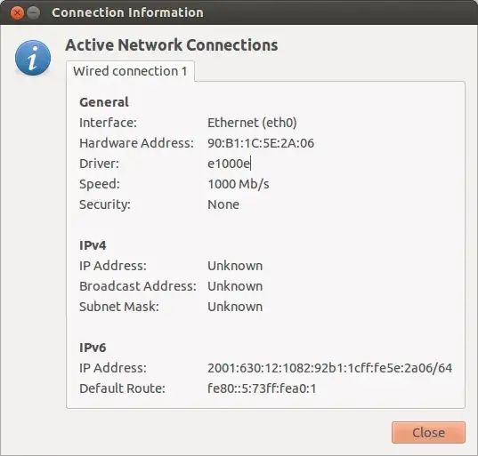

And here is a screenshot of the connection information (when connected to the wired network), it seems odd as there is no ipv4 addr

I note:
SIOCSIFFLAGS: Cannot assign requested address
That suggests there are settings in /etc/network/interfaces that are interfering and conflicting with Network Manager. Please check:
    sudo gedit /etc/network/interfaces
The file should conatin nothing more than:
    auto lo
    iface lo inet loopback
Proofread, save and close gedit. Restart NM:
    sudo service network-manager restart
Now does it connect? If not, please check for any settings in Network Manager. For instance, if you've asked for a static address of 192.168.1.203 and the college network uses 192.168.55.0 etc., you won't connect. Remove any extra settings in NM.
