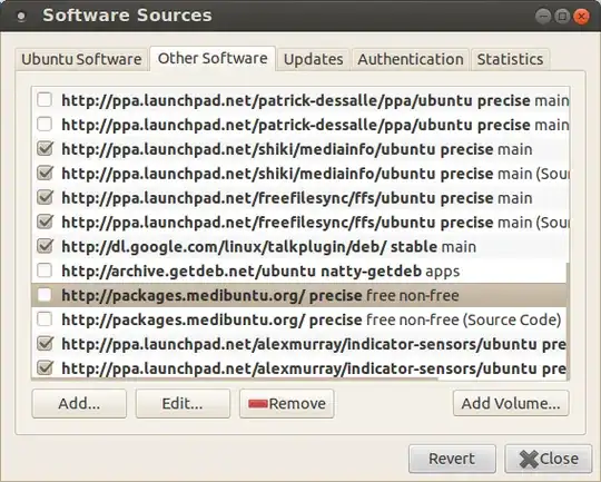

GUI Method
  1. Open Synaptic Package Manager (Press Super/Winkey then type Synaptic Package Manager and click the first app result that shows up named Synaptic Package Manager)
  2. In the app's menu, select Settings -> Repositories
  3. Select the Other Software tab, then scroll down and uncheck or remove all entries for packages.medibuntu.org (see screenshot)
    Synaptic Package Manager Other Software tab
  4. Click Close
  5. Click the Reload button in Synaptic Package Manager (runs apt-get update behind the scenes)
