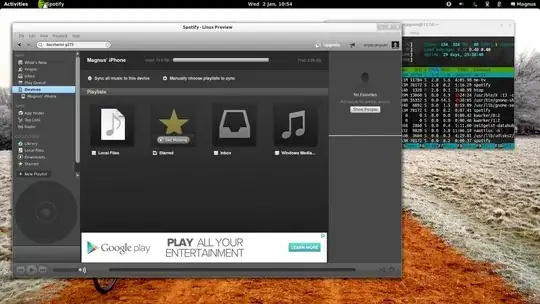

Have you tried Spotify? I'm using it to sync music with my iphone (iOS 5)...
http://www.spotify.com/uk/download/previews/
Edited in response to Eliah Kagan's request below:
Follow the instructions at this link or as copied from it below:
  1. Add this line to your list of repositories via the software settings dialogue
    deb http://repository.spotify.com stable non-free
  2. If you want to verify the downloaded packages, you will need to add our public key
    sudo apt-key adv --keyserver keyserver.ubuntu.com --recv-keys 94558F59
  3. Run apt-get update
    sudo apt-get update
  4. Install spotify!
    sudo apt-get install spotify-client
Install the Spotify app via the iPhone app store on the iPhone and create a Spotify account (free).
Follow the instructions in Spotify to add your local music folder and then to connect your iPhone - briefly: open the spotify app in Ubuntu and on the iPhone, make sure you are signed in to your Spotify account on both devices and they should connect automatically over wifi. Sync music. Enjoy.
