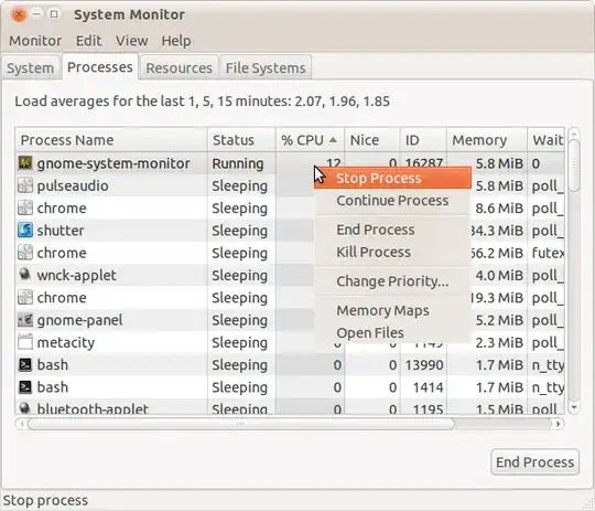

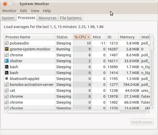

Once the GUI launches you can select the Processes tab which will list all the running processes. Sort by the CPU column to find the most CPU intensive task
cpu
Lastly you can right click that task and choose to end it, stop it, or kill it. Killing it will immediately stop and remove that process from the system.

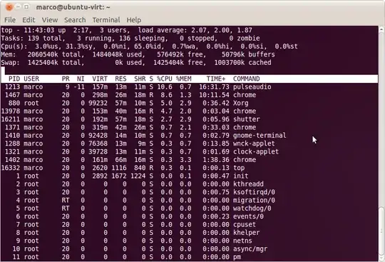

If you have a terminal open you can simply type top this will list all the running processes similar to that of the Processes tab in the GUI
top

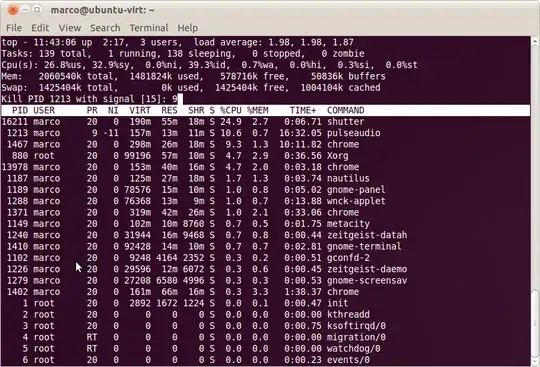

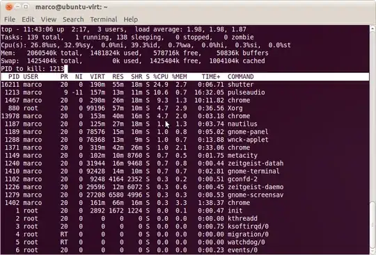

Within top it is CPU sorted by default - so the top most CPU intensive tasks are at the top. At anytime you can press the letter k to kill a process
k
Simply type the PID of the process you wish to kill and press enter. It will ask for a Kill signal to send. To kill the process nicely use the default 15 - to kill it right away "Do not pass go, do not collect $200" use 9.
sigkill
The process will then be terminated.
