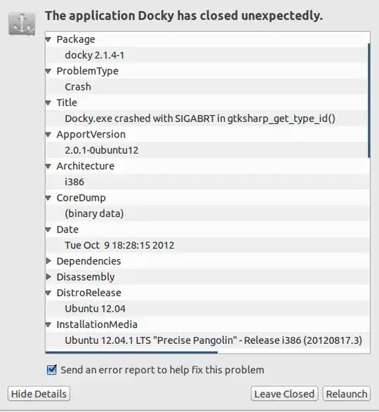

I use the latest Docky for Ubuntu 12.04 Precise. Sometimes it gives me this error:
I think it happens when I try to edit the Main Menu and use Synaptic. I'm not sure. Docky is set up to be hidden on a window doge.
Please give me a patch or a stable version of Docky. Thanks!

The latest stable package of Docky is already available at ppa:docky-core/stable. I'd recommend the following (because, maybe the package was corrupted):
  • Remove existing Docky.
  • Add the stable PPA
  • Update software list
  • Install Docky from the PPA
    sudo add-apt-repository ppa:docky-core
    sudo apt-get remove docky
    sudo apt-get update && sudo apt-get install docky
