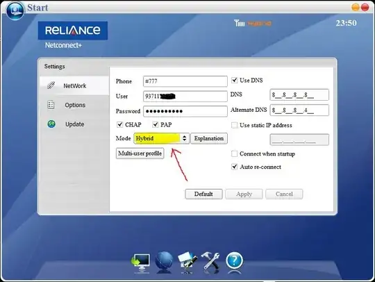

Solution 1: (If you have access to Windows Machine)
Just go to the Reliance Netconnect Plus UI in Windows machine and in Settings change the 'Mode' to 'Hybrid'.
By doing this I found that the Reliance Netconnect Plus is recognized by Ubuntu quickly and
Now log in back to Ubuntu and connect to the internet through 'Network Manager'.
Using this method you will be registered on CDMA home network and can access the internet quickly.
The main disadvantage of this method is that we are running it under 'Hybrid' mode, which means that the internet may switch to 'CDMA 1x' mode and the internet speed will go down.
For me this happens only for 5-10 minutes then I'm again switched to fast Netconnect+ mode.
To overcome this disadvantage you may use Solution 2.

Internet using wvdial works out of box. Now you can change the Network Mode to 'Netconnect+' by using Reliance Netaconnect Plus UI in windows and log back to Ubuntu to use the uninterrupted broadband using wvdial.
